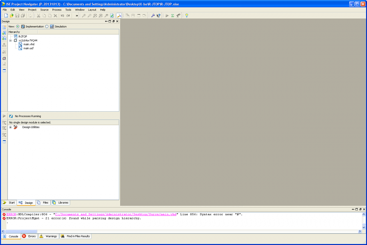

    è proprio qui che ho l'errore:
    ERROR:HDLCompiler:806 - "C:/Documents and Settings/Administrator/Desktop/Surce/main.vhd" Line 856: Syntax error near "#".
    ERROR:ProjectMgmt - 21 error(s) found while parsing design hierarchy.
  2. #62
    DrSchottky
    Da dove hai scaricato il source?
  3. #63
    56
    [url]https://github.com/DrSchottky/R-JTOP?files=1[/url]
  4. #64
    DrSchottky
    E ti da errore quando cerchi di aggiungerli?

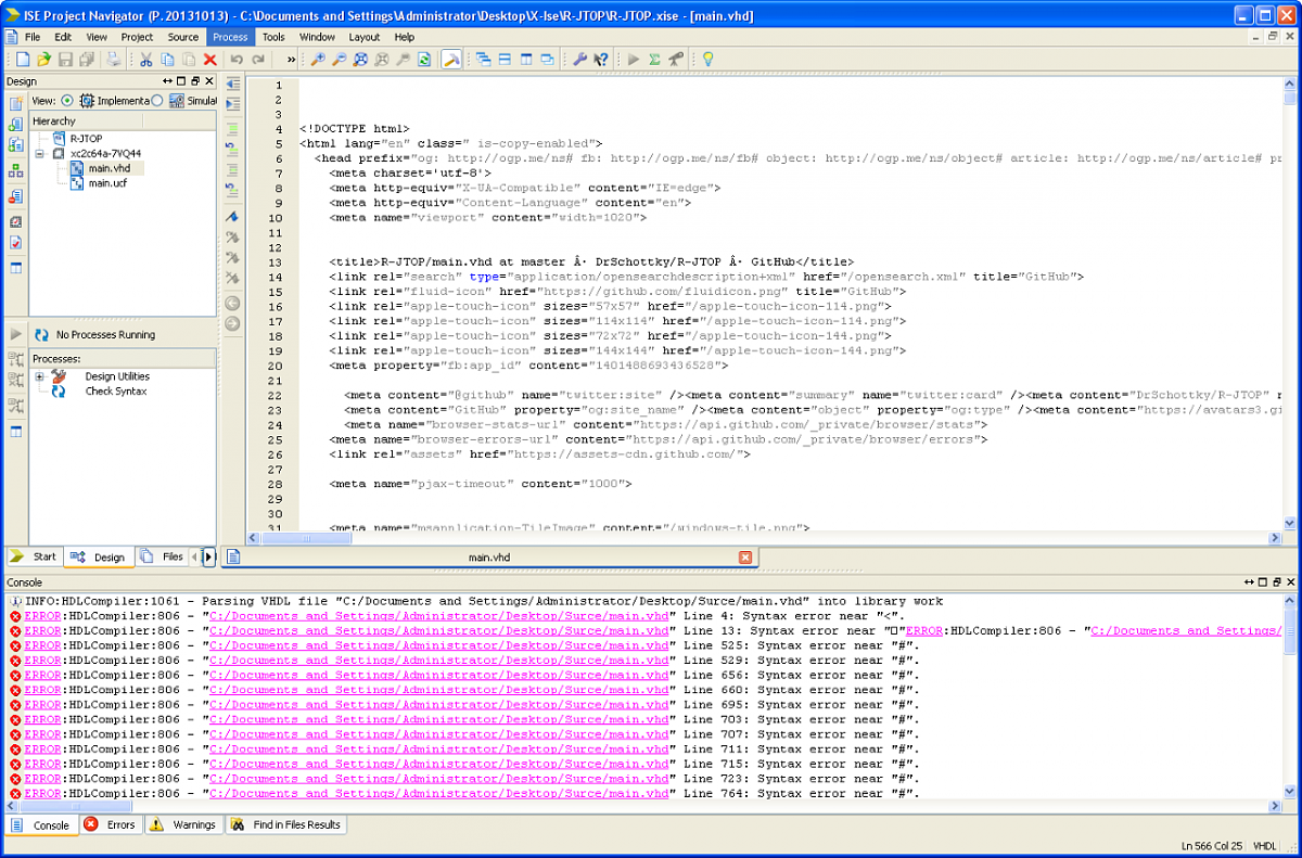

    Si, dall'immagine si vedono solo le ultime 2 righe della Console. Gli errori sono questi:
    INFO:HDLCompiler:1061 - Parsing VHDL file "C:/Documents and Settings/Administrator/Desktop/Surce/main.vhd" into library work
    ERROR:HDLCompiler:806 - "C:/Documents and Settings/Administrator/Desktop/Surce/main.vhd" Line 4: Syntax error near "<".
    ERROR:HDLCompiler:806 - "C:/Documents and Settings/Administrator/Desktop/Surce/main.vhd" Line 13: Syntax error near "�"ERROR:HDLCompiler:806 - "C:/Documents and Settings/Administrator/Desktop/Surce/main.vhd" Line 513: Syntax error near "#".
    ERROR:HDLCompiler:806 - "C:/Documents and Settings/Administrator/Desktop/Surce/main.vhd" Line 525: Syntax error near "#".
    ERROR:HDLCompiler:806 - "C:/Documents and Settings/Administrator/Desktop/Surce/main.vhd" Line 529: Syntax error near "#".
    ERROR:HDLCompiler:806 - "C:/Documents and Settings/Administrator/Desktop/Surce/main.vhd" Line 656: Syntax error near "#".
    ERROR:HDLCompiler:806 - "C:/Documents and Settings/Administrator/Desktop/Surce/main.vhd" Line 660: Syntax error near "#".
    ERROR:HDLCompiler:806 - "C:/Documents and Settings/Administrator/Desktop/Surce/main.vhd" Line 695: Syntax error near "#".
    ERROR:HDLCompiler:806 - "C:/Documents and Settings/Administrator/Desktop/Surce/main.vhd" Line 703: Syntax error near "#".
    ERROR:HDLCompiler:806 - "C:/Documents and Settings/Administrator/Desktop/Surce/main.vhd" Line 707: Syntax error near "#".
    ERROR:HDLCompiler:806 - "C:/Documents and Settings/Administrator/Desktop/Surce/main.vhd" Line 711: Syntax error near "#".
    ERROR:HDLCompiler:806 - "C:/Documents and Settings/Administrator/Desktop/Surce/main.vhd" Line 715: Syntax error near "#".
    ERROR:HDLCompiler:806 - "C:/Documents and Settings/Administrator/Desktop/Surce/main.vhd" Line 723: Syntax error near "#".
    ERROR:HDLCompiler:806 - "C:/Documents and Settings/Administrator/Desktop/Surce/main.vhd" Line 764: Syntax error near "#".
    ERROR:HDLCompiler:806 - "C:/Documents and Settings/Administrator/Desktop/Surce/main.vhd" Line 800: Syntax error near "#".
    ERROR:HDLCompiler:806 - "C:/Documents and Settings/Administrator/Desktop/Surce/main.vhd" Line 804: Syntax error near "#".
    ERROR:HDLCompiler:806 - "C:/Documents and Settings/Administrator/Desktop/Surce/main.vhd" Line 812: Syntax error near "#".
    ERROR:HDLCompiler:806 - "C:/Documents and Settings/Administrator/Desktop/Surce/main.vhd" Line 816: Syntax error near "#".
    ERROR:HDLCompiler:806 - "C:/Documents and Settings/Administrator/Desktop/Surce/main.vhd" Line 836: Syntax error near "#".
    ERROR:HDLCompiler:806 - "C:/Documents and Settings/Administrator/Desktop/Surce/main.vhd" Line 848: Syntax error near "#".
    Ultima modifica di zendrscworl; 01-10-15 alle 15: 25
  6. #66
    DrSchottky
    Per favore apri il main.vhd(doppio click) dallo Hierarchy panel.
  7. #67
    56
    Citazione Originariamente Scritto da DrSchottky Visualizza Messaggio
    Serve in modalità testo?
  8. #68
    DrSchottky
    Ma cosa hai scaricato?L'HTML?
    È palesemente un file non valido.
    [url]https://github.com/DrSchottky/R-JTOP[/url]
    Prova a confrontare il tuo main.vhd con quello su github...
  9. #69
    56
    Colpa mia! ho cliccato con il DX e ho fatto salva destinazione con nome!
    Ora ho scaricato R-JTOP-master.zip e ha compilato correttamente!
    Stasera se ho tempo apro iMPACT e carico main.jed
    Grazie per l'aiuto!
