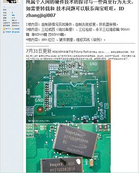

    we ragà anche su logic c'e scritto che state lavorando sulle 4gb !!!!il team consoleopen....
    [url=http://www.logic-sunrise.com/news-520995-corona-v2-dump-de-la-nand-boot-sur-xell.html]Corona V2 : Dump de la Nand, Boot sur XeLL ![/url]

    Stryp
    ^__^ è regolare !
    Mais malheureusement mauvaise nouvelle et du moins pour le moment : zhangjiqi007 est d'origine asiatique ce qui rends le travail avec les autres devs plus difficile, mais plusieurs devs travaillent déjà dessus (Redline, tuxuser, c0z, Team ConsoleOpen...)

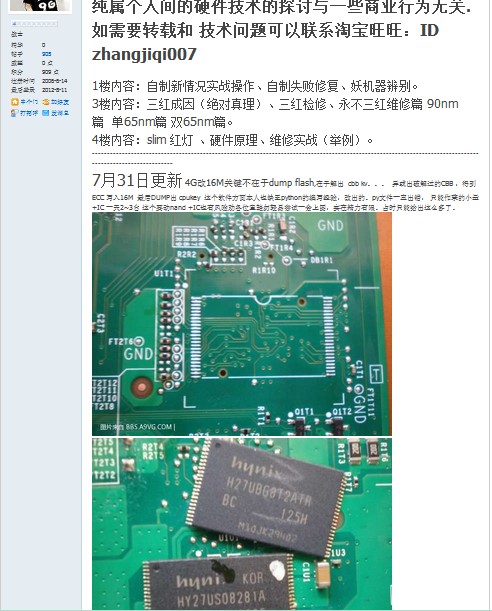

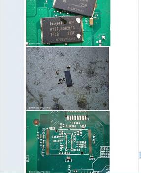

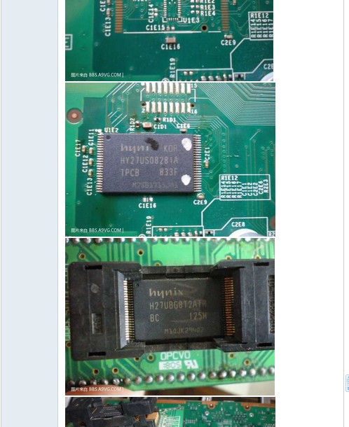

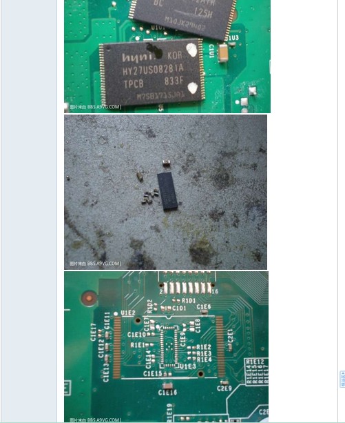

    Junior Member L'avatar di ZackWaRRioR
    Aug 2012
    12
    Hello everyone, sorry I don't speak italien but what I can tell you is that orkid1818 read the information on the forum where zhanjuqi007 wroth about all his tests, also on this same topic he gave out his 64Mb nand file and his cpukey to prove his work. Now orkid1818 is trying to do this be he can't because he doesn't know how to do it.
    Anyway for everyone else here is how it should be done
    you need to transform your corona v2 motherboard like if it was a corona v1, both motherboard are the same except they have some component that are different around the nands
    Here is what you have to take off:
    TOP MOTHERBOARD
    -the phison chip
    -R1E1, R1E2, R1E3, R1E4
    -C1E6, C1E7, C1E8, C1E9, C1E10, C1E14, C1E15, C1E16
    BOTTOM MOTHERBOARD
    -the corona v2 nand
    -R1R1, R1R2, R1R3, R1R4, R1R5, R1R6, R1R7, R1R8, R1R9, R2R2
    -C1R1, C1R2, C1R3
    This is what you need to solder back on:
    TOP MOTHERBOARD
    -the corona v1 nand with the corona v2 ecc
    -C1D1, C1E17
    -R1D1 & R1D2
    BOTTOM MOTHERBOARD
    -R2T1, R2T2, R2T6, R2T7, R2T9, R2T10, R2T11, R2T14
