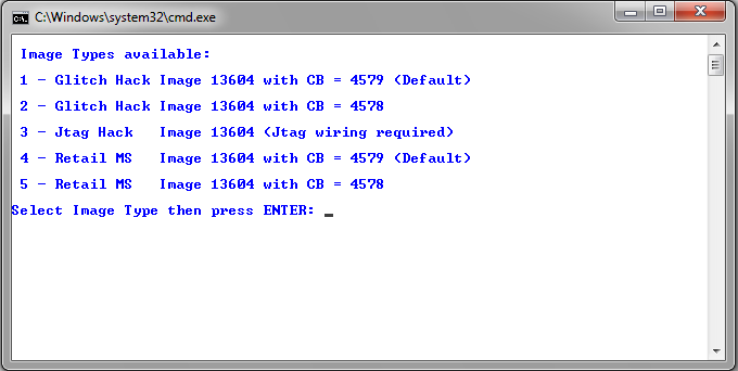

    Alcune importanti note per chi ha problemi a glitchare alcune console come potete notare dal changelog
    360_Multi_Builder_v0.4 on 27/11/2011
    - Returned to using Dashlaunch v2.25 patch-set to avoid the "PlayDVD" problem
    with some Liteon Drives that requires the fcrt.bin for proper function.
    - Fixed a bug in the Xell/Ecc script regarding Jaspers with CB version 6751.
    [URL="http://www.multiupload.com/MJEMV5ZNXL"]download[/URL]

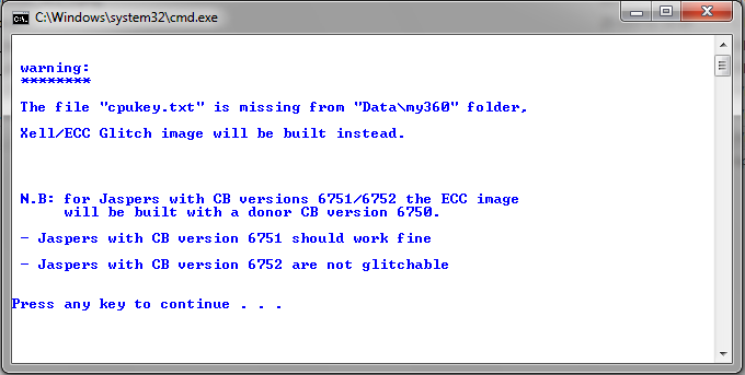

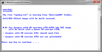

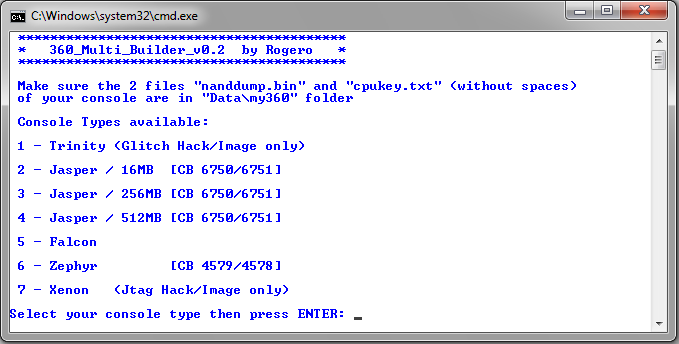

    360_Multi_Builder_v0.2 on 03/11/2011
    - Added Proper Support for Jasper with CB 6751 (where a donor CB 6750 will be used)
    - Please note that Jasper with CB 6752 are not Glitchable even if the image was created
    - Added Proper Support for Zephyr with CB 4578 (Program now supports both 4578 & 4579)
    - Added a notification to the Python Script about the Falcon CB 5772 being not Glitchable

    04/11/2011 UPDATE: incollo una domanda e relativa risposta da parte di Rogero (il creatore del tool)
    DOMANDA: Sorry, what is this about some CBs being not glitchable? I thought the glitch hack would work for ANY 360 except Xenons... Did I miss some news?
    RISPOSTA DI ROGERO:Jasper cb_6752 / Falcon cb_5772 & any FAT that has a 2-part CB (CB_A and CB_B) are not glitchable at all because they are not compatible with the Glitch Hack at the moment.
    You can Open your nand dump with 360FlashToolv0.97 and you can see your 2BL / [CB] version.
    I had reports about latest Slim board revision released (Corona) which had the Hana chip removed that makes it not compatible at all with the Glitch Hack too.
    Quindi in sintesi dice che alcune FAT non sono glitchabili temporaneamente xchè il codice attuale non le supporta. Presumibilmente dovrà uscire un update. Parla anche della nuova revisione slim (Corona) dicendo di aver avuto segnalazioni che non è "del tutto"(non so cosa voglia dire) compatibile con Glitch Hack.
