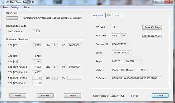

    Questo è quello che mi riporta 360 Flash Tool, inserendo ovviamente la sua CPUKey.

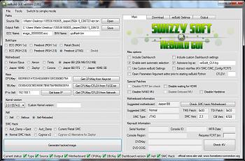

    Ok dato il tutto in pasto a xeBUILD GUI 2.082 settato tutto come da immagine ma purtroppo mi restituisce un'errore e non crea il freeboot come mai?
    Allego anche il LOG
    Swizzy's xeBuild GUI version 2.082
    Log Started: Friday 07/09/2012 17:58:03
    *** Some console information ***
    CB Version: 6723
    Serial number: 105536190805
    Console region: PAL/Europe (0x02FE)
    DVDKey: D3BAF1911493A5B6D9F31E3B5E229F48
    Console ID: 0246CEA203
    MFR-Date: 17-02-09
    OSIG String: PLDS DG-16D2S 7485
    FCRT.bin Required: False
    Using xell-reloaded for JTAG/SMC hack
    Copying Normal (Old) hack patched SMC... Done!
    dashlaunch NOT included...
    Copying nand to data directory, this may take a while... Done!
    Parameters sent to xeBuild:
    -noenter -t jtag -c jasperbb -d data -f 15574 -b DD88AD0C9ED669E7B56794FB68563EFA -p B83FB931A7CEA60498E512EC890BD75A output.bin
    Building nand using xeBuild (this may take a while):
    xeBuild v1.04.515
    building jtag image
    ***** ERROR: naddump.bin is a ZEROPAIR/XELL image, discarding
    ***** WARNING: cfldv was not set anywhere, setting it to 1
    **** could not read kv.bin (-1) ****
    ******* ERROR: critical bootloader files are missing, cannot proceed!
    ***** FATAL BUILD ERROR: -1 unable to complete NAND image
    xeBuild Finished. Have a nice day.
    xeBuild ERROR: image build error
    ERROR: There was one or more fatal errors: 1 errors during the build process
    Cleaning data and temporary directories... Done!
    ****** The app has now finished! ******
