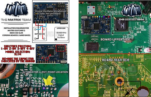

    Matrix Glitcher II firmware upgrade v1.5
    - Added Corona motherboard compatibility (see installation
    diagram at [url=http://infinitymod.com]The MATRiX Team - Home of the matrixglitcher360 and matrix nand programmer[/url] ).
    To Upgrade :
    - Place all 4 switches in the OFF position to place the Matrix Glitcher II in
    update mode.
    The blue led should start flashing to signal update mode (you might need to
    cycle power supply or turn your xbox360 off and on again if it doesn't).
    - Connect the Matrix USB external programmer to the Glitcher II using the
    4 pins flat cable and to your PC using a mini-USB cable.
    - Launch the included program.
    The upgrade program will automatically scan all available COM ports until
    it finds a Glitcher II and start the firmware upgrade.
    A green screen will signals the successfull completion of the upgrade
    process.
    - Disconnect the flat cable from the Glitcher II and set the 4 switches
    according to your Xbox 360 model.
    Quick switch settings chart :
    SW 1 2 3 4
    ON ON ON ON ZEPHYR
    ON OFF ON ON FALCON
    ON ON OFF ON OPUS
    ON OFF OFF ON JASPER
    ON ON ON OFF TRINITY
    ON OFF ON OFF PHAT RGH 2.0
    ON ON OFF OFF CORONA
    OFF OFF OFF OFF UPDATE MODE
    Download: : [URL="www.infinitymod.com/Download/MG2-CORONA16MB.zip"]Matrix Glitcher II firmware upgrade.[/URL]

    Bene erano mesi che non vedevo news targate Team Matrix. Ottimo per chi ha il matrix II e vuole montarci un quarzo per utilizzarlo sulle corona. Resta solo da capire una cosa: i tempi di glich con questa soluzione di quanto si discostano rispetto ai tempi dei CPLD + recenti tipo lo storm v2?

    provato il Matrix Glitcher II Corona ready (con oscillatore a 48Mhz già installato) con una corona e glitch molto bene !!
