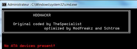

Istruzioni:
HddHacker supports two flashing modes, Auto and Manual. Typing HddHackr at a DOS prompt
will start auto mode. In auto mode all hard drives will be detected automatically.
In manual mode you can enter all the parameters used for flashing by hand.
The following help screen is displayed if you start HddHacker with a wrong number of
arguments:
HDDHACKR [C|D|F|R] [PORT] [DRIVE POS] [SECTOR FILE] [RESTORE FILE]
C: Create Partitions 0/2/3
D: Dump sector 16-22 from XBOX360 HDD to file
F: Flash Western Digital firmware
R: Restore Western Digital firmware
PORT: Port to send command to e.g. 09F0
DRIVE POS: A0 for Master, B0 for Slave
SECTOR FILE: Sector dump file e.g. HDDSS.BIN
RESTORE FILE: Firmware restore file e.g. UNDO.BIN
Example for create, dump, flash and restore:
HDDHACKR C 09F0 A0
HDDHACKR D 09F0 A0 HDDSS.BIN
HDDHACKR F 09F0 A0 HDDSS.BIN UNDO.BIN
HDDHACKR R 09F0 A0 UNDO.BIN
