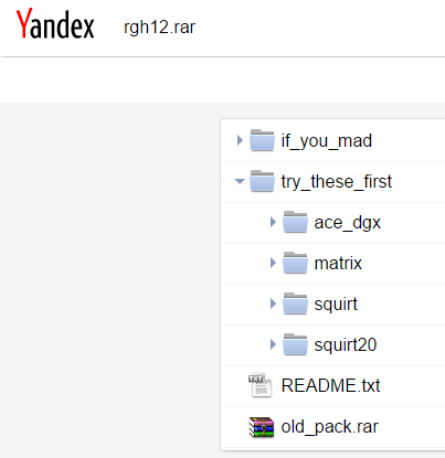

    [url]http://www.teamx360.co.uk/forum/-15432-s-development-section/rgh-1-2/2061-rgh-1-2?3150-Rgh-1-2=[/url]
    Clicca su UPDATED Links For Files Above.
    Son tutti dentro il pack ufficiale ! che bellezza
